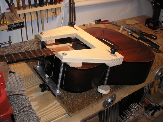

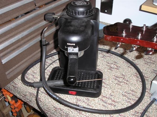

I can't add much to whats been said.Here are some pics
Neck Removal Jig
Steamer Outer

OMG, is that a cut fretboard extension a la 1973??!! I cringe when I think of the ones I cut in those days.
PostPosted: Tue Jul 24, 2007 11:51 am
oh, well, since someone else pointed it out: this does fall into the category of techniques which were once considered to be acceptable but today are severely frowned upon.
when i first started it was common to see this done, but the only sort of circumstance i know of which justifies doing it these days is the large amounts if epoxy or other glues which one can find in the dovetail joints of some imports. the neck won't loosen because you can't get the steam into the joint so the fbe must be removed to have access to dig the glue out and work the joint loose.
